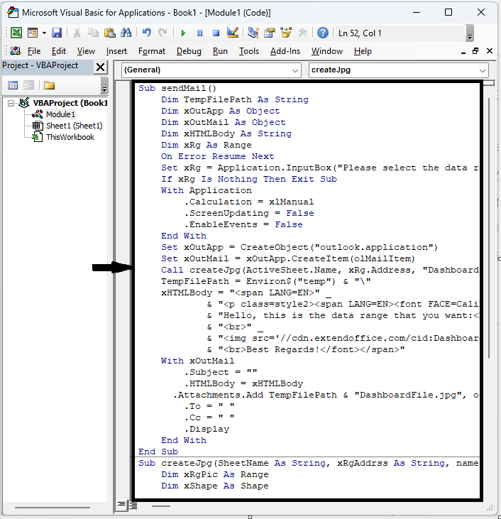

步骤 2
然后点击“插入”并选择“模块”,然后将下面的代码复制到文本框中。
插入 > 模块 > 复制
代码
Sub sendMail()
   Dim TempFilePath As String
   Dim xOutApp As Object
   Dim xOutMail As Object
   Dim xHTMLBody As String
   Dim xRg As Range
   On Error Resume Next
   Set xRg = Application.InputBox("Please select the data range:", "Paste Range Images", Selection.Address, , , , , 8)
   If xRg Is Nothing Then Exit Sub
   With Application
      .Calculation = xlManual
      .ScreenUpdating = False
      .EnableEvents = False
   End With
   Set xOutApp = CreateObject("outlook.application")
   Set xOutMail = xOutApp.CreateItem(olMailItem)
   Call createJpg(ActiveSheet.Name, xRg.Address, "DashboardFile")
   TempFilePath = Environ("temp")&""
   xHTMLBody = "<span LANG=EN>" _
     &"<p class=style2><span LANG=EN><font FACE=Calibri SIZE=3>" _
     &"Hello, this is the data range that you want:<br> " _
     &"<br>" _
     &"<img src='//cdn.extendoffice.com/cid:DashboardFile.jpg'>" _
     &"<br>Best Regards!</font></span>"
   With xOutMail
      .Subject = ""
      .HTMLBody = xHTMLBody
      .Attachments.Add TempFilePath&"DashboardFile.jpg", olByValue
      .To = " "
      .Cc = " "
      .Display
   End With
End Sub
Sub createJpg(SheetName As String, xRgAddrss As String, nameFile As String)
   Dim xRgPic As Range
   Dim xShape As Shape
   ThisWorkbook.Activate
   Worksheets(SheetName).Activate
   Set xRgPic = ThisWorkbook.Worksheets(SheetName).Range(xRgAddrss)
   xRgPic.CopyPicture
   With ThisWorkbook.Worksheets(SheetName).ChartObjects.Add(xRgPic.Left, xRgPic.Top, xRgPic.Width, xRgPic.Height)
      .Activate
      For Each xShape In ActiveSheet.Shapes
         xShape.Line.Visible = msoFalse
      Next
      .Chart.Paste
      .Chart.Export Environ("temp") & "" & nameFile & ".jpg", "JPG"
   End With
   Worksheets(SheetName).ChartObjects(Worksheets(SheetName).ChartObjects.Count).Delete
Set xRgPic = Nothing
End Sub

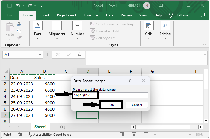

第3步
然后点击F5运行模块。然后选择要复制的单元格范围,然后点击确定。
F5 > 运行 > 选择单元格 > 确定
如何将一系列单元格粘贴为Excel中消息正文的图像?

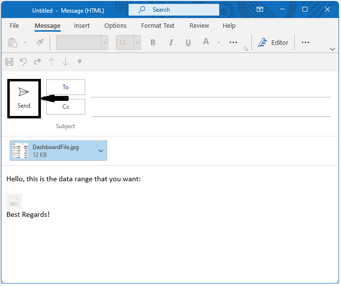

然后在Outlook中点击发送以完成任务。
