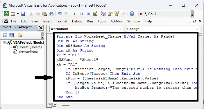

然后将以下代码复制到文本框中。
代码
Private Sub Worksheet_Change(ByVal Target As Range)
Dim xC As String
Dim xWSName As String
Dim xA As String
xC = "D:D"
xWSName = "Sheet1"
xA = "A1"
   If Intersect(Target, Range("D:D")) Is Nothing Then Exit Sub
   If IsEmpty(Target) Then Exit Sub
   xNum = (Sheets(xWSName).Range(xA).Value)
   If (Target.Value) > (Sheets(xWSName).Range(xA).Value) Then
      MsgBox Prompt:="The entered number is greater than cell A1, please enter again! ", Title:="Pop Message Greater "
   End If
End Sub
在代码中,A1是单元格,D:D是输入值的列。
