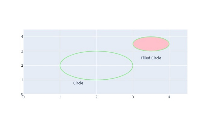

应用颜色/形状/大小的完整代码如下所示 –
import plotly.graph_objects as go
fig = go.Figure()
# Create scatter trace of text labels
fig.add_trace(go.Scatter(
x=[1.5, 3.5],
y=[0.75, 2.5],
text=["Circle", "Filled Circle"],
mode="text",
# Set axes properties
fig.update_xaxes(range=[0, 4.5], zeroline=False)
fig.update_yaxes(range=[0, 4.5])
# Add circles
fig.add_shape(type="circle", xref="x", yref="y", x0=1, y0=1, x1=3, y1=3, line_color="LightGreen",)
fillcolor="pink", x0=3, y0=3, x1=4, y1=4, line_color="LightGreen", )
# Set figure size
fig.update_layout(width=716, height=400)
fig.show()
输出
执行时,它将在浏览器上显示以下输出:
同样,您可以尝试创建不同类型的图像。
