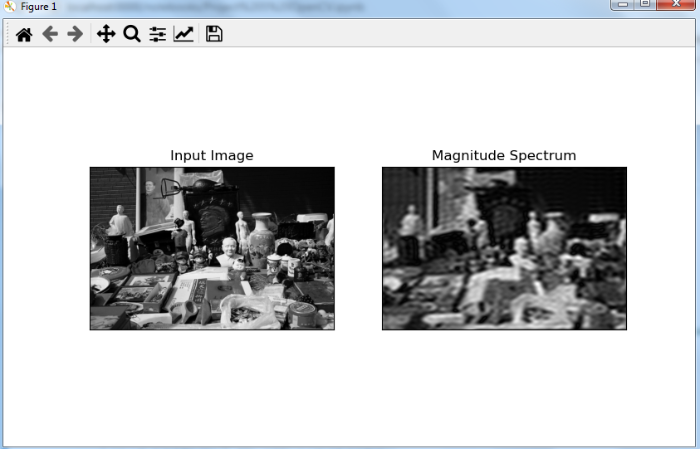

在这个程序中,我们通过输入图像找到离散傅里叶变换。我们使用逆函数如ifftshift()和idft()来重建图像。
import numpy as np
import cv2
from matplotlib import pyplot as plt
# read the input image
img = cv2.imread('film.jpg',0)
# find the discrete fourier transform of the image
dft = cv2.dft(np.float32(img),flags = cv2.DFT_COMPLEX_OUTPUT)
# hift zero-frequency component to the center of the spectrum
dft_shift = np.fft.fftshift(dft)
rows, cols = img.shape
crow,ccol = rows//2 , cols//2
mask = np.zeros((rows,cols,2),np.uint8)
mask[crow-30:crow+30, ccol-30:ccol+30] = 1
# apply mask and inverse DFT
fshift = dft_shift*mask
f_ishift = np.fft.ifftshift(fshift)
img_back = cv2.idft(f_ishift)
img_back = cv2.magnitude(img_back[:,:,0],img_back[:,:,1])
# visualize the images
plt.subplot(121),plt.imshow(img, cmap = 'gray')
plt.title('Input Image'), plt.xticks([]), plt.yticks([])
plt.subplot(122),plt.imshow(img_back, cmap = 'gray')
plt.title('Magnitude Spectrum'), plt.xticks([]), plt.yticks([])
plt.show()
输出
当您运行以上Python程序时,它将产生以下输出窗口-
