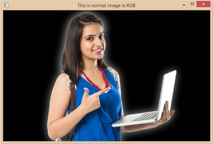

# Display the image
cv2.imshow('This is normal image in RGB', img)
cv2.waitKey(0)
cv2.destroyAllWindows()

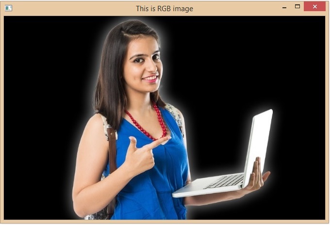

# Convert the image from BGR to RGB
rgb_img = cv2.cvtColor(img, cv2.COLOR_BGR2RGB)
# Display the RGB image
cv2.imshow('This is RGB image', rgb_img)
cv2.waitKey(0)
输出
原始图像 −

回到RGB −
使用Python和OpenCV转换BGR和RGB
