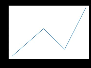

# impoting matplotlib library with an alias name
import matplotlib.pyplot as matplot
# input first list
inputList_1 = [1, 4, 6, 8]
# input first list
inputList_2 = [2, 6, 3, 9]
# plotting the inputList_1, inputList_2 values by taking inputList_1 on x-axis
# and inputList_2 on y-axis.
matplot.plot(inputList_1, inputList_2)
# giving the label/name for x-axis
matplot.xlabel('X-axis')
# giving the label/name for y-axis
matplot.ylabel('Y-axis')
# giving the title of the plot
matplot.title('Plot for Data Visualization')
# displaying the graph
matplot.show()
输出
在执行时,上面的程序将生成以下输出:
