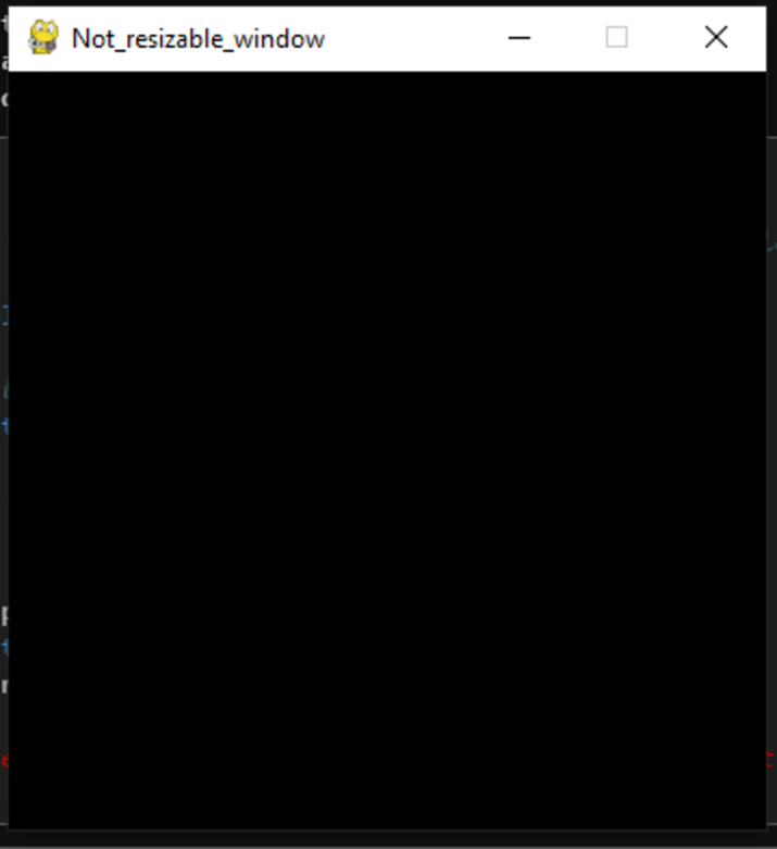

普通pygame窗口的程序示例
import pygame
# We are creating a screen with size 350*350 which is not resizeable
scr = pygame.display.set_mode((350, 350))
# Now set the title for the window
pygame.display.set_caption('Not_resizable_window')
# Here we run the window
running = True
while running:
for event in pygame.event.get():
if event.type == pygame.QUIT:
running = False
# quit pygame after closing the window else the window will not get closed.
pygame.quit()
输出
这是一个不可调整大小的pygame窗口,或者我们可以说是一个普通的pygame窗口。如果我们点击关闭按钮,由于我们的代码中有pygame.quit(),所以将退出pygame。

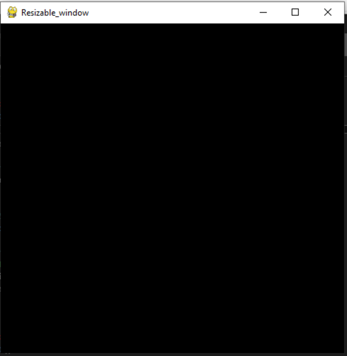

可调整大小的pygame窗口示例程序
import pygame
# We are creating a screen with size 550*550 which is resizeable
scr = pygame.display.set_mode((550, 550),pygame.RESIZABLE)
pygame.display.set_caption('Resizable_window')
running = True
while running:
running = False
pygame.quit()
输出
这两段代码唯一的区别是,我们在声明窗口大小时添加了一个属性,允许用户根据自己的偏好调整pygame窗口大小。
scr = pygame.display.set_mode((550, 550), pygame.RESIZABLE)
pygame.RESIZABLE 允许我们调整窗口大小。
