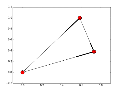

import networkx as nx
def create_cycle_graph(num_nodes):
   cycle_graph = nx.cycle_graph(num_nodes)
   return cycle_graph
def visualize_graph(graph):
   pos = nx.circular_layout(graph)
   nx.draw(graph, pos, with_labels=True, node_size=1000, node_color='skyblue',
font_size=10)
   plt.show()
if __name__ == "__main__":
   num_nodes = 5
   cycle_graph = create_cycle_graph(num_nodes)
   visualize_graph(cycle_graph)

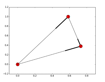

num_nodes = int(input("Enter the number of nodes for the Cycle Graph: "))
pos = nx.circular_layout(cycle_graph)
nx.draw(cycle_graph, pos, with_labels=True, node_size=1000,
node_color='skyblue', font_size=10)
plt.show()
