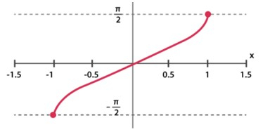

图表
不同角度的反正弦值
- sin^-1(0) = 0
sin^-1(1/2) = ㄫ / 6
sin^-1(1/√2) = ㄫ / 4
sin^-1(√3/2) = ㄫ / 3
sin^-1(1) = ㄫ / 2
